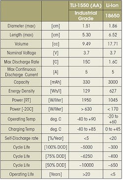

The table provides a comparison between typical lithium-ion batteries and industrial grade lithium-ion batteries.

Consumer-grade Li-ion cells are reasonably inexpensive and widely available, but drawbacks include a life expectancy of less than five years and 500 recharge cycles, a moderate temperature range of -10°C to 60°C, and an inability to deliver high pulses.
Industrial-grade Li-ion batteries are the preferred choice for long-term deployment in remote and inaccessible locations. They are able to operate for up to 20 years and 5,000 full recharge cycles, provide a much wider temperature range (-40°C to 85°C), deliver high pulses (5 A for an AA-size cell), and feature glass-to-metal hermetic seals, whereas consumer rechargeable batteries use crimped seals more prone to leakage.
