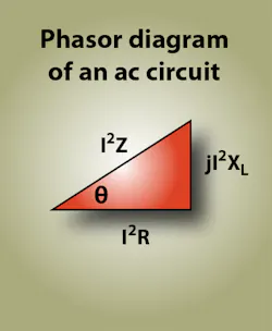

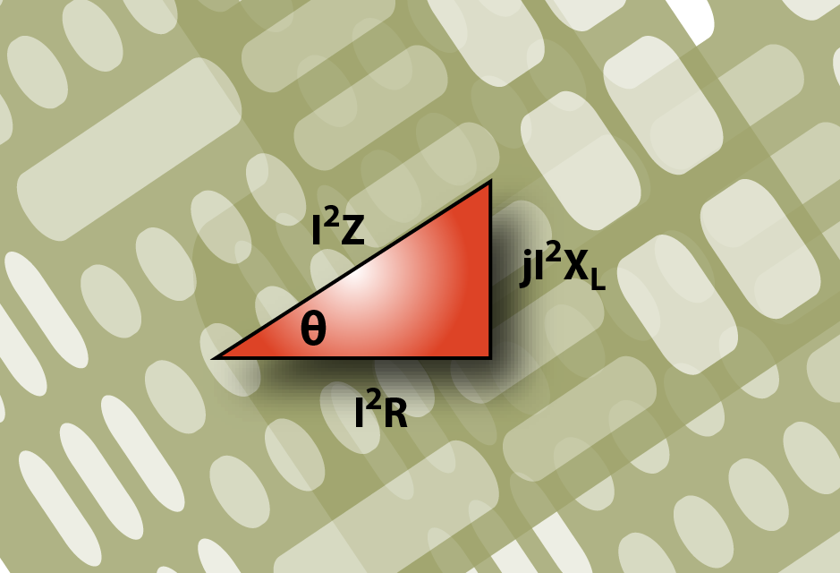

To show power relationships in ac circuits, it is often convenient to start with the well-known phasor diagram representation of an ac circuit:
Here Z, R, and Xare impedance, resistance, and inductive reactance respectively.
θ is the angle of lag of the current behind the voltage, as before. To obtain what's called the power triangle shown here, each side of the triangle is multiplied by the average current I.
× (I Z) = I2 Z = E I
× ( I R) = IR = E I cos θ
× (I XL) = I2 XL = E I sin θ
Here sin θ is called the reactive factor.
The term E I sin θ is called reactive volt-amperes and is given in units of var.
One source of confusion associated with reactive volt-amps is that they are sometimes referred to as a measure of reactive power. In reality, reactive volt-amps are a measure of energy, not power. Reactive volt-amps represent the energy supplied to the circuit during part of the cycle, then returned to the system during the part of the cycle when the system inductance is discharging.
