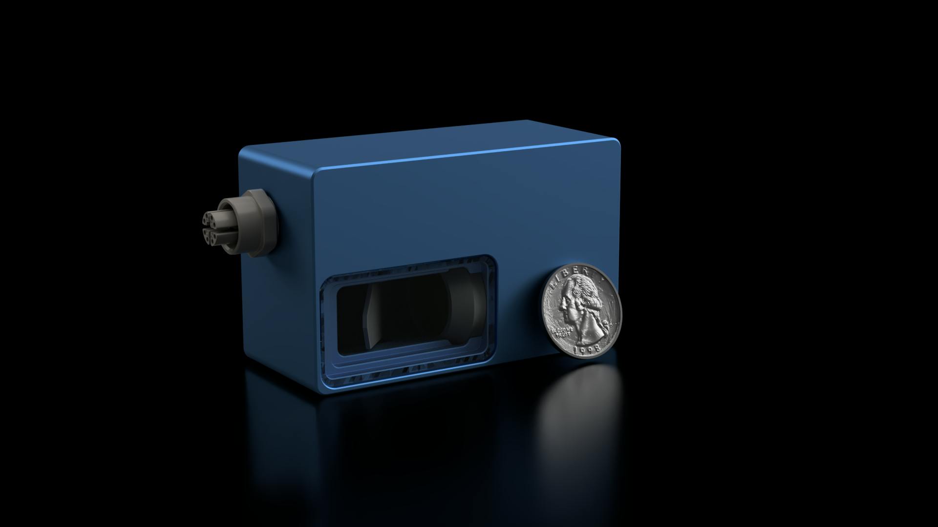

The sensor uses frequency modulated continuous wave (FMCW) technology, which is made to enable instant velocity at each point on top of traditional distance, reflectivity and intensity measurement.
Described as an effective and affordable LiDAR solution on a chip with solid-state beam steering, Voyant Photonics’ Carbon sensor is compact—approximately the size of a fingernail—and designed to provide high-resolution object detection and segmentation abilities at up to 200 meters. This is achieved through the integration of optics into a photonic integrated circuit (PIC).
Key features include:
  • High-resolution object detection and dynamic segmentation capability.
  • Real-time environmental updates at a rate of up to 20 times per second.
  • Effective operation in various weather conditions, including dust, fog, rain and snow.
  • Reflective object handling.
  • Software-defined LiDAR (SDL) for real time adjustments to frame rate and field of view for focused area detection.
At a weight of 250 grams, the sensor is made for durability, featuring IP67 dust and water protection, as well as resistance to shock and vibration. The low power consumption of the FMCW laser technology provides safety for users.
