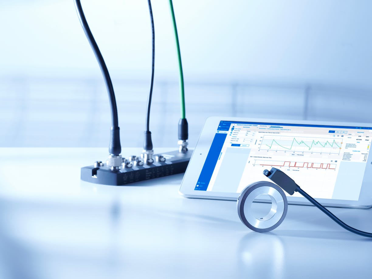

Lugo and Schneider also introduced attendees to Baumer’s Sensor Suite of software, which allows plants to parametrize, monitor and evaluate IO-Link devices.

ML & SS: We are showing different sensors with IO-link, including our awarded Baumer Sensor Suite software, together with the Baumer USB-C IO-link master for easy parametrization and the UF200 Sensor, our newest ultrasonic product.
