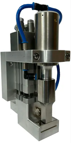

Rinco’s new Micro-35 Actuator is a welding unit that operates on a 35-kHz frequency and was designed for continuous fin sealing and zipper crushing applications for the packaging industry.

Ultrasonic sealing or welding is a preferred sealing method that operates on the principle of converting electrical energy into high-frequency mechanical vibrations, typically in the ultrasonic range (around 20 kHz or higher). The heat is generated only inside of the materials to be welded. In addition to forming strong, airtight and watertight bonds, it offers speed, precision and sanitary sealing, making it ideal for assembling products like medical devices, automotive components and consumer electronics. The lightweight actuator system makes it viable for continuous movement zipper crushing applications where the actuator must move with the film.
Rinco’s press release characterized ultrasonic welding as a more sustainable process when compared to traditional methods and has the capability of sealing recycled and bio-based films as well as many paper-based materials. Thermal sealing processes are blind and often affected by ambient conditions and are unable to confirm seal quality. Rinco noted that intelligent ultrasonic systems provide a high level of process data, offering insight into the sealing process.

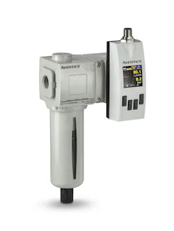

Combined with the Emerson Compressed Air Manager, the Energy Manager presents a streamlined view of energy costs and compressed air usage across a packaging line, factory and site. To this end, Emerson now also offers a high flow model of an advanced sensor that propels compressed air monitoring beyond individual machines to benefit larger air lines and systems. The Aventics Series AF2 Flow Sensors brings expanded capabilities to compressed air consumption and energy efficiency, allowing users to optimize across an entire packaging facility and improve overall plant sustainability.

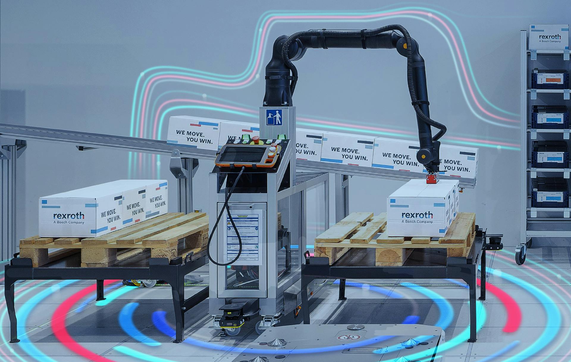

Multi-Tech Palletizing and Conveying
Bosch Rexroth demonstrated its complete factory automation solutions for CPG manufacturing. A multi-tech collaborative palletizing demo, it is built on Bosch Rexroth’s aluminum structural framing, consisting of a VarioFlow plus conveyor system that delivers high accuracy with unprecedented speed, combined with a Kassow 7-axes collaborative robot. The modular VarioFlow plus plastic chain conveyor is a high-performance versatile plastic chain conveyor system with components that are easy to assemble in both horizontal and vertical configurations. In addition, Linear Motor Modules feature a zero-backlash direct drive. The LMMs come ready-to-install, with axes are available in sizes 140 mm, 180 mm and 220 mm.
