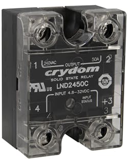

An example of these types of SSRs can be seen in Sensata’s LN series of relays, which incorporate a low noise trigger circuit designed to help use of additional EMI filter.
The LN Series offers ratings up to 75 Amps at 528VAC in standard panel mountable hockey-puck style device with Integrated input/output overvoltage protection. It is also available with standoffs for PCB mounting if needed, and is UL recognized and TUV certified.
Some key applications where the LN series has been well-suited include commercial ovens, household appliances and medical equipment.
