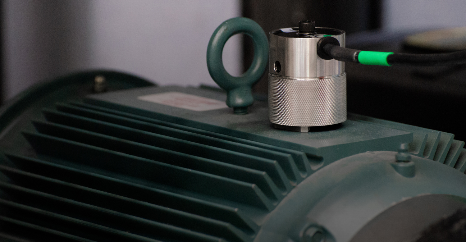

A motor is “watched” by an OnSite Condition Monitor from Dynapar that includes a tri-axial accelerometer and temperature sensor.
