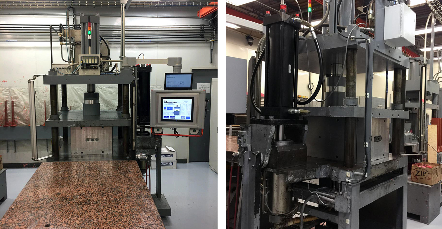

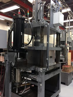

Black cylinder (upper left) compresses the hot wax. The cylinder (top center) clamps the mold closed against the injection nozzle on the stationary platen.

Wilson engineer Dave Pellerin recommended that an electrohydraulic motion controller for the cylinder that operates the wax extruder would give them precise control. Pellerin recommended Solidiform use the RMC75E from Delta Computer Systems, Inc. of Battle Ground, Washington.
At the beginning of the process, a wax billet is loaded into the extruder cylinder with the temperature maintained by heater bands on the exterior. The extruder cylinder then forces warm wax through a heated hose to fill the mold, which is held closed by the clamp cylinder. The motion controller uses setpoints entered from a database for injection velocity and pressure to ensure a consistent fill.
The wax’s compressibility is different from that of air, and the control system monitors and adjusts for this by reading the output of a pressure transducer in the wax line. Using this information, the injection pressure can be dynamically changed as the mold fills.
The controller reacts to pressure changes by increasing or decreasing its command to the servo control valve. As soon as air is evacuated, the pressure almost immediately returns. By this time, the controller must respond quickly by lowering the command voltage back to the appropriate level (and hence reducing the flow of hydraulic fluid to the injector cylinder) to minimize overshoot. The motion controller also compensates for viscosity differences in the wax from one production run to another. The controller ensures set pressure is exact and repeatable from shot to shot.
The Delta motion controller monitors piston pressure and position in each cylinder. The control algorithm employed is called “dual loop control.” The inner control loop ensures the position and velocity of the piston matches the profile as it injects wax, while the outer loop verifies that the pressure exerted as the piston moves does not exceed set limits.

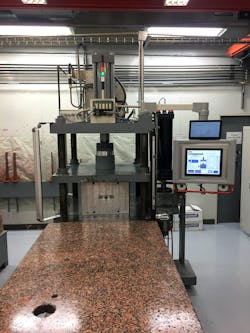

All injection functions are coordinated using a Red Lion touchscreen, the primary operator interface. The HMI also interfaces with an Allen-Bradley PLC, which controls power unit sequencing and safety mechanisms.
After the injection cycle is complete, the RMC75E creates a slight negative pressure in the wax line as the clamping cylinder retracts. This ensures no residual wax squirts out as clamp pressure is removed. All pressure values are displayed on the HMI.
The operation of the press is controlled and monitored on a Red Lion control panel. All injection functions are coordinated using the touchscreen, the primary operator interface.
