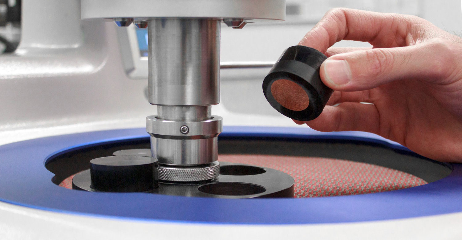

Faster throughput. For high-volume production operations, quality assurance labs are busy through the entire eight-hour shift, and in some cases more than 24 hours. Going from rough cut to polished finish can take up to an hour. Newer grinding-polishing systems take 6 to 8 minutes off the process with the added advantage of processing multiple samples simultaneously.
Reducing cross-contamination. Newer machines have self-cleaning features that apply water and spin the platen at a high speed. As the platen spins, debris is removed and the machine is rinsed clean, greatly reducing the potential for cross-contamination.
Reducing operator fatigue. With a manual machine, a day of testing can mean a lot physical exertion, leading to errors as time moves on and making this approach unsuitable for high-volume labs. The problem is the need to perform the task manually on a machine that either has a raised platen, or else having to rest the wrists on raised edges and lips during grinding and polishing stages.
Stents help keep coronary arteries open and reduce the chance of a heart attack. A stent is inserted into the clogged artery with a balloon catheter. The balloon is inflated, and the stent expands and locks into place. This holds the artery open and allows blood to flow more freely.
The advantage of semi-automatic grinder-polishers is that the machines do the work of applying pressure to the sample during a preparation routine without the need of an operator manually handling the samples. Once the samples are loaded on the machine, the operator can press the start button and walk away until it is time to reload new samples on the platen.
Processing consistency. Along with handling multiple samples, semi-automatic grinder-polishers provide consistency by applying the same force for each sample as well as the ability to adjust the forces to match different sized specimens.
Repeatability. Semi-automatic grinding-polishing machines can provide a touchscreen to enable the technicians to enter in processing routines for the different materials. The technician can enter the routine on the color touchscreen and recall it from memory when that batch of parts comes into the lab. Panel functions can include time, speed, single/central force mode, head rotation, force, pause/stop buttons, and what actions were used (on/off).

Reduced vibration. Most manual grinding-polishing machines have sheet metal bases. A cast-aluminum base on semi-automatic machines greatly reduces vibration during grinding for a more consistent, higher-quality sample.
