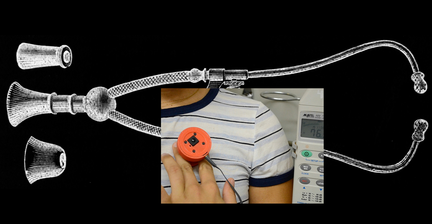

Researchers simulated an extremely noisy environment in the lab (the sound meter shows levels of around 70 decibels). They compared the audio heard through a top-notch commercial stethoscope, in which the breathing sounds are mixed with ambient noise, to that heard through the Johns Hopkins smart stethoscope, which uses active acoustic filtering to isolate the breathing sounds. (Credit: John Hopkins University)

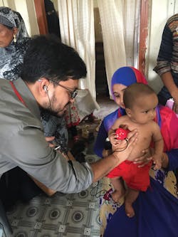

A health worker in Bangladesh listens to sounds from a boy’s lungs with the help of the Johns Hopkins smart stethoscope, which cancels out extraneous noise and identifies telltale signs of pneumonia. (Credit: Dr. Eric D. McCollum)
Their effort sprang from the multitude of diseases being misdiagnosed in underdeveloped countries. Worldwide, several children die from pneumonia and lung ailments, infecting almost one million children a year. Underdeveloped areas do not have access to modern diagnosing equipment and rely on stethoscopes to diagnose these common lung ailments.
There are modern electronic stethoscopes on the market. They work by converting acoustic waves into electric signals that are then processed in a device to amplify sounds. The device from John Hopkins mitigates noise by improving the coupling between the patient’s body and the best piece. It swaps the rubber hose for an electric cable and employs digital noise-control techniques to capture a stronger signal.
The device has an external microphone in the chest piece to collect ambient sounds to help reduce noise through adaptive signal analysis. An onboard microprocessor serves as the operating system which lets the user adapt the tool to different applications.
