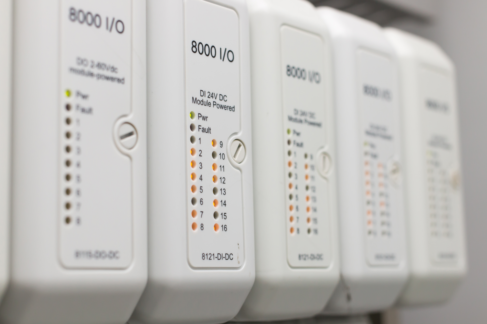

How hard is it to keep track of a binary electronic system? It can only be in one of two states: on or off, open or closed, 0 or 1. While that may be correct, let’s suppose that there is no strict definition of what voltage levels constitute a “0” or a “1.” Let’s now also suppose that the voltage levels for a 0 or 1 can change during transmission. This could be for several reasons—noise, line impedance, electrostatic discharge (ESD), power surges, or perhaps even a combination of them all.
How can you be certain that what started out as a 0 is still a 0 and that what started out as a 1 is still a 1? Imagine also trying to keep track of dozens of these signals simultaneously and quickly. What may initially have appeared to be a relatively trivial task has taken on a whole new level of complexity. Welcome to the world of the digital input (DI), a subset of the IO module (Fig. 1) that sits between an industrial sensor and a PLC.
