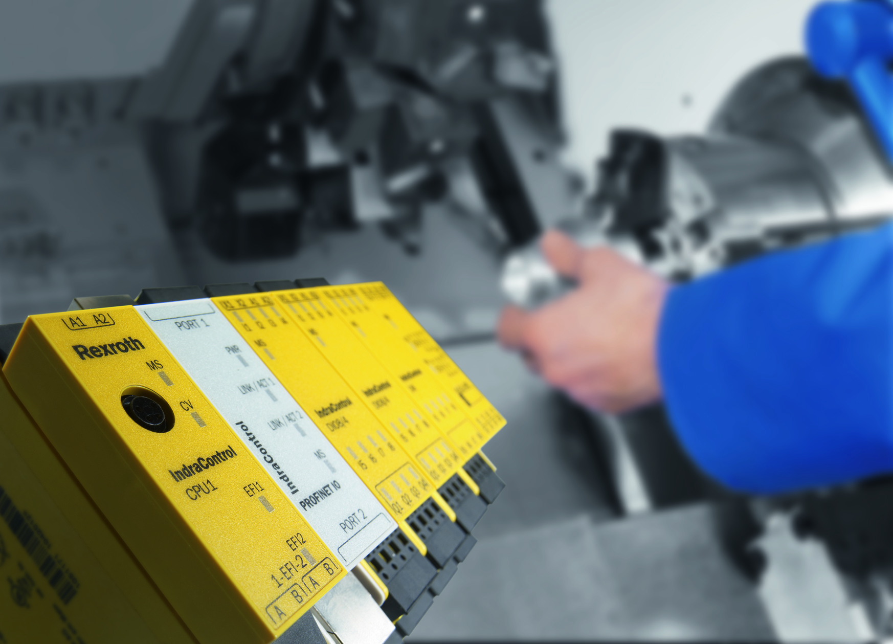

Centralized or decentralized safety? Drive-based safety can be realized with central or decentralized/distributed safety controls.
Benefits of centralized safety. Centralized-safety PLCs are a solution that can be joined with a motion/logic PLC. When the entire motion/logic program is combined with the safety program, the whole application is contained in a single project, making the commissioning and troubleshooting process easier.
With centralized safety PLCs, centralized safety controls can be networked together to share safe and non-safe data between controls if required for the application. These controls use remote safety input/outputs (I/O) technology, which gives the user freedom to locate safety I/O around the machine.
An advantage of having remote I/O is that the I/O can be either safe I/O or standard I/O on the remote module, making it easier to start-up and reducing labor costs.
Benefits of decentralized safety. Decentralized safety solutions include remote safety PLCs with easy-to-use function block programming to set conditions of safety I/O to achieve a safe state. A remote safety PLC is the ideal solution for distributed control machines, like transfer lines, because it allows individual control of the complete line. This means the safety control is independent of the motion control, allowing programmers to use separate PLCs for motion and safety. Remote safety PLCs can also be networked, providing a path for safety information to be shared among stations within a machine or separate machines.
