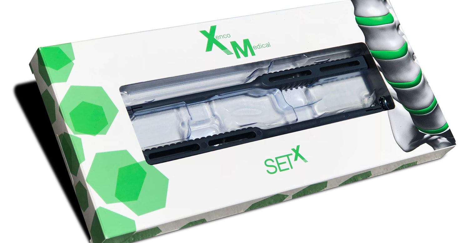

A spinal implant from Xenco Medical and the hardware needed to implant it are shown with its sterile packaging. Note the dual barriers and trays which provide redundant durability and protection against dirt and pathogens.

The full packaging on an Anterior Cervical Spine Implant from Xenco Medical shows how the implant is kept sterile during transport and storage.

Dual barriers can also be provided by thermoformed trays, like in this sterile packaging designed for Xenco Medical’s spinal implants.
