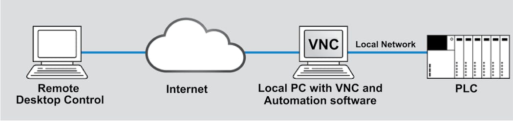

A remote desktop connection (RDC) network.
Some machine builders rely on traditional remote-access such as virtual private networking (VPN) and remote desktop connection (RDC), which uses virtual network computing (VNC). Both improve service and let builders respond quicker to customers. However, the limits on traditional remote access hold back machine builders from providing better service.

Similarly, a remote desktop connection to a PLC/controller is neither straightforward nor convenient. It requires, at a minimum, a dedicated PC with all the relevant software tools installed and connected to the machine. As a business grows, the number of dedicated PCs and software-tool licenses increases, leading to a steep rise in IT costs. In addition, managers need to consider PC maintenance and the software tools installed on them. Machine builders prefer identical versions of the software tools be installed on both client and host machines because this simplifies troubleshooting. To do so, IT engineers assigned to maintenance need to coordinate updates to software tools between the server and client sides.

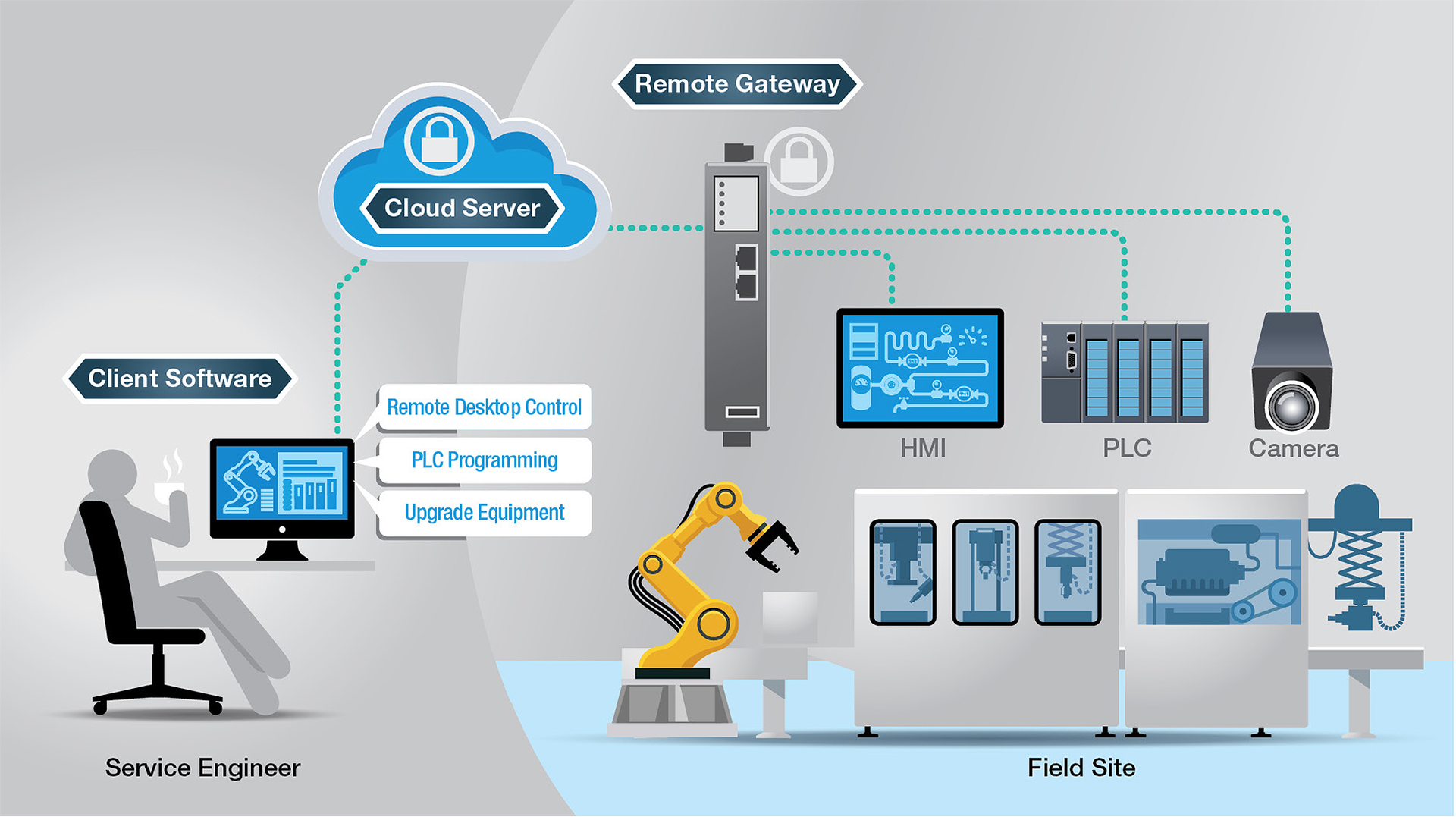

Cloud-based access is a new type of secure, remote access that would allow flexible remote access to field machines. Its network topology consists of three components: a remote gateway, a cloud server, and client software. Remote gateways connect to field equipment to access and control them. Client software gets installed on the engineer’s PC or desktop. The remote gateway and client software initiate outbound secure connection requests to the cloud server.
Promo and Graphic: G4 Promo and graphic
A cloud-based secure remote access network.
The cloud server is installed on a cloud-based platform such as Amazon Web Services or Microsoft Azure. It maps the connection requests and, after successful authentication on both sides, establishes a connection.
Cloud-based access implements network topology that enables the creation of outbound connections in the form of remote access tunnels, thereby effectively overcoming the challenges presented by traditional VPN and remote desktop control technologies. In addition, cloud remote access based brings machine builders the following benefits:
