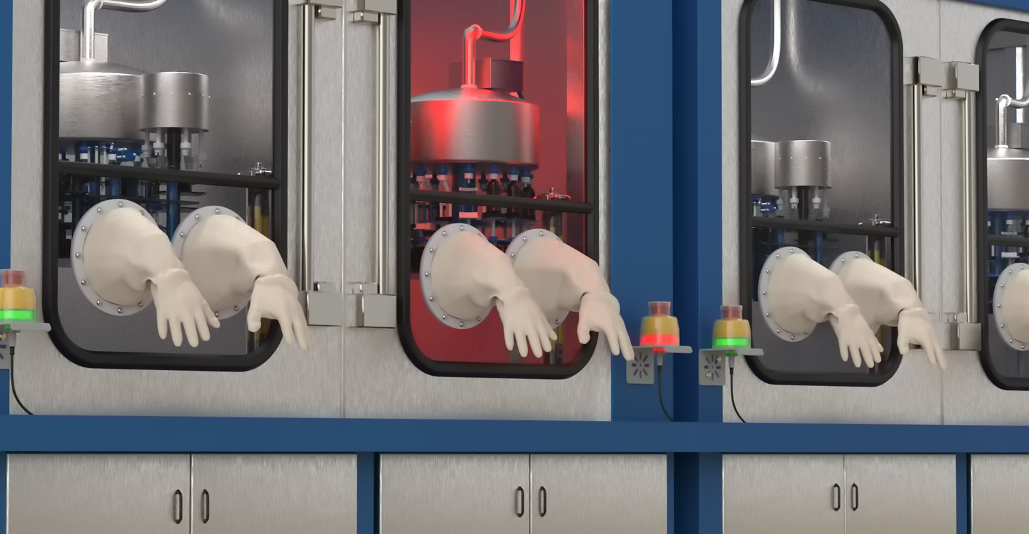

Multicolored LED strip lights provide unmistakable status indication in operators’ natural sightlines, while tower lights provide indication for supervisors at a glance.

For machine builders, the more significant application for combined illumination and indication is machine lighting. Bright, even machine lighting is important because it allows operators to effectively monitor machine processes and see clearly when troubleshooting, refilling material, or completing other manual tasks on the machine. With multicolor strip lights, the same task lights can immediately let the operator know when attention is required.
For larger machines, multicolor lighting can help direct operators to the specific location on the machine that requires attention. A machine can be configured to activate LEDs at a specific zone to illuminate in red or yellow, alerting operators or supervisors that attention is needed. The color alerts the operator to the machine condition and directs them to the exact location on the machine that needs attention. When the operator opens the guard door to evaluate the problem, the lighting within the machine can be configured to turn to white task lighting, providing clear visibility to the operator—all with one device.
As another example, end users can install multicolor strip lights directly over machines, illuminating the whole machine in a different color if an issue arises. In areas where there are many tower lights that can be hard to quickly differentiate, lighting up the entire machine ensures greater visibility and quicker response time when problems arise.
