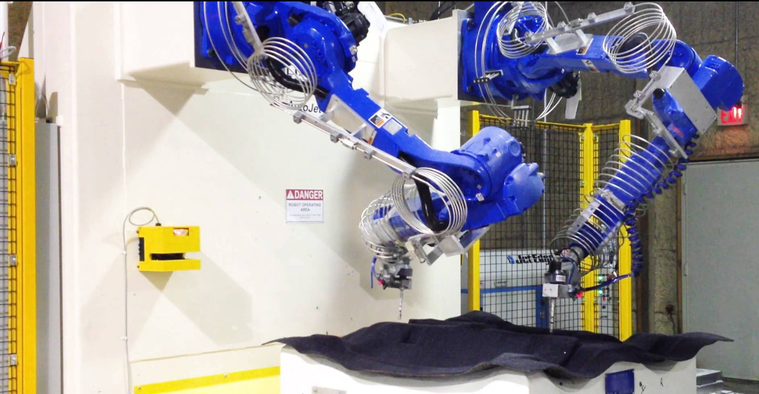

Waterjets use a stream of high-pressure water mixed with abrasives to slice through titanium up to a foot thick, under control of a six-axis robot that can maneuver the waterjet nozzle across the part, shaping the graceful contours of jet engine turbine blades and blisks (bladed rotors).
An abrasive waterjet controlled by a robot cuts a 3D part, a titanium blisk for a commercial jet engine. (Courtesy of Shape Technologies Group)
Traditionally, robotic waterjet has been more common for softer materials and other industries. More recently, though, it’s been adopted by the aerospace industry for cutting metals and composites, as robots have proven to be durable and accurate enough to meet the demanding tolerances required by the aerospace industry.
One company in the forefront of this technology is Shape Technologies Group in Kent, Wash. It includes Aquarese, a firm that assembles waterjet cutting robots, including the only abrasive waterjet that shoots water out at 94,000 psi (6,500 bar). Flow International Corp. manufacturers the ultra-high-pressure pumps and waterjets used by Aquarese in its turnkey machines for the aerospace, energy, and automotive industries. The robots themselves are provided by Stäbuli.
Robotic waterjet cutters use an articulated arm with six degrees of freedom, letting the cutting nozzle approach the workpiece from virtually any angle. Once cutting, the nozzle follows a smooth, accurate, and repeatable toolpath to create precision cuts and contours. For metal cutting, waterjets typically rough-cut components which are then sent to final milling operations.
