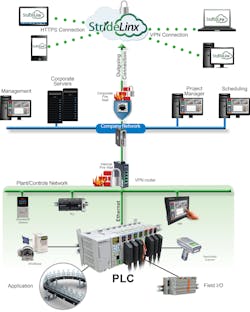

Hosted VPN Solution
A hosted VPN solution provides secure IIoT connectivity with simple setup and network configuration. These solutions usually include a local VPN router, a cloud-hosted VPN server, and a remote VPN client. Automation system components are connected locally to the VPN router, which connects to the cloud server. The VPN client connects by laptop or PC to the cloud, and ultimately to the local automation system components (Fig. 1).
1. AutomationDirect’s StrideLinx secure hosted VPN solution for IIoT connectivity has no monthly fees if data use is under 5 GB a month. (Courtesy: AutomationDirect)
To accomplish this, the local VPN router makes a VPN connection to the cloud server immediately upon startup, but the VPN client only connects upon a verified request from the remote user. Once both connections have been made, all data passing through this VPN tunnel is secure.
Communication is initiated by the local router to the cloud-based server via an outbound connection through standard ports that are typically open, such as HTTPS. This usually requires no changes to the corporate IT firewall, thus satisfying IT security concerns. Traditional VPN solutions require IT involvement and oversight in order to open inbound firewall ports, which often poses problems.
Hosted VPN solutions only require simple router configuration because the router (Fig. 2) is connected to a predefined cloud server. This allows the hosted VPN vendor to deliver the router preconfigured, so the user only needs to add basic network information. The router’s default firewall settings keep the plant floor network separate from the corporate network.

Security risk is minimal with this solution because the remote client connection to the cloud server uses the robust encryption standard SSL/TLS. The required TLS key exchange, crucial for security, is done in accordance with industry standard 2048-bit RSA with SHA-256.
To further enhance security, some vendors provide advanced user management, event logging, and two-factor authentication. This method of authentication requires a second time-based password generated at login, providing an extra level of security.

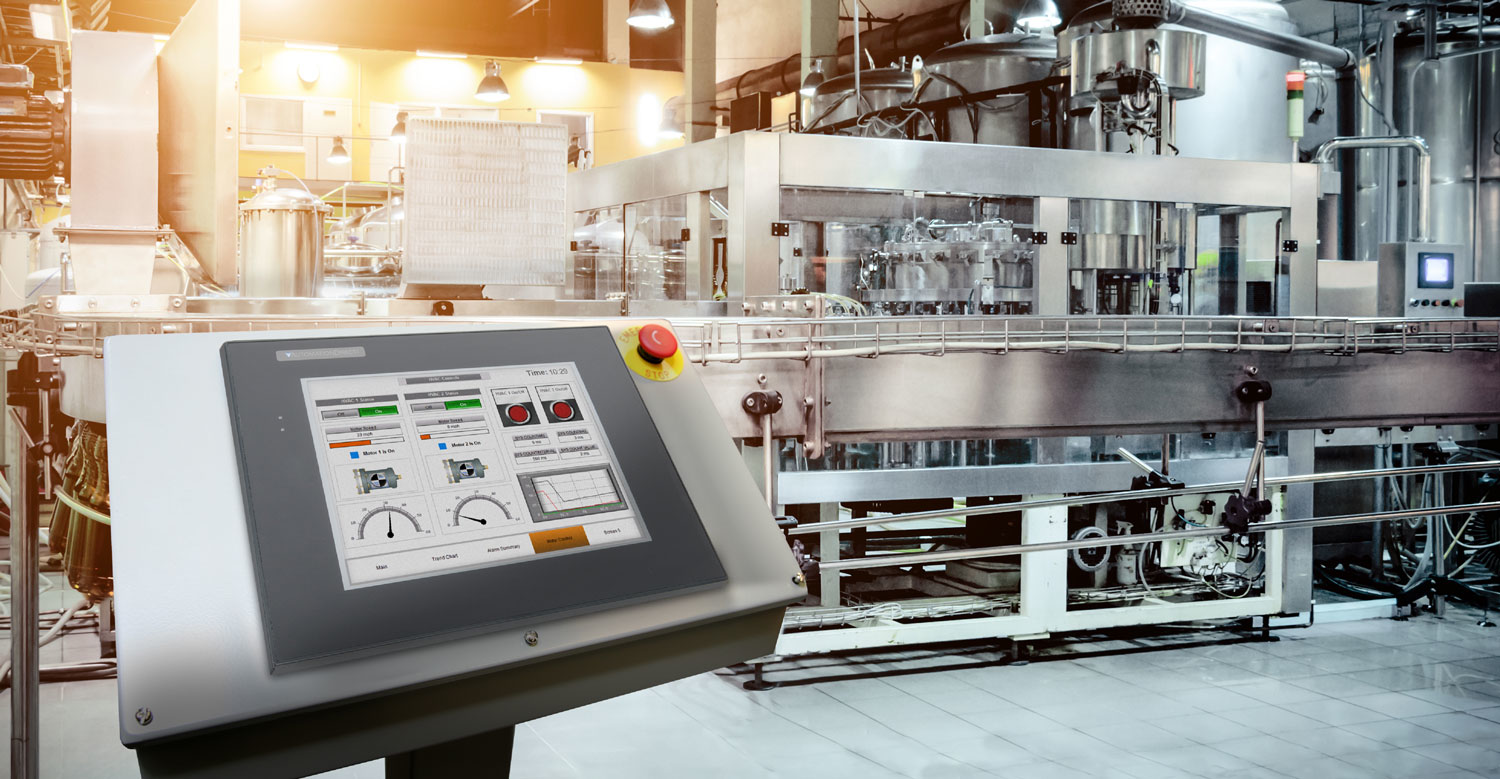

A traditional VPN solution requires a third-party HMI, either PC-based or embedded (Fig. 3), to provide data logging and widgets for configuring remote access screens. Many hosted VPNs do not require an HMI because they provide their own graphical interface capabilities. With these solutions, users can configure dashboards using widgets for remote access via their PC or mobile device (Fig. 4). Users can also configure alerts and notifications to indicate when parameters fall outside a predefined range. Creating remote access viewing screens can be cumbersome if this feature is not provided, so this must be taken into account when evaluating competing hosted VPN solutions.
3. When traditional VPNs are used, a local HMI, such as this AutomationDirect C-more panel, is often part of the solution. (Courtesy: AutomationDirect)
