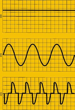

The waveforms associated with ac voltages are either sinusoidal (sine waves), or non-sinusoidal (sawtooth, square, and ripple, for example.). True-rms DMMs display the “rms” (root mean square) value of these voltage waveforms. The rms value is the effective or equivalent dc value of an ac voltage.
Voltage signals can have a variety of shapes. Here are three (top to bottom): dc, ac sine wave, and non-sinusoidal AC.
Some basic DMMs are “average responding,” giving accurate rms readings if the ac voltage signal is a pure sine wave. Average responding meters cannot accurately measure non-sinusoidal signals. Non-sinusoidal signals are accurately measured using DMMs designated “true-rms” up to the DMM’s specified crest factor. A crest factor is the ratio of a signal’s peak-to-rms value. It’s 1.414 for a pure sine wave, but is often much higher for a rectifier current pulse, for example. As a result, average responding meters will often read much lower than the actual rms value. But most meters are true rms these days.
A DMM’s ability to measure ac voltage can be limited by the signal’s frequency. Most DMMs accurately measure ac voltages with frequencies from 50 to 500 Hz, but a DMM’s ac measurement bandwidth can be hundreds of kilohertz wide. Such a meter reads a higher value because it “sees” more of complex ac signals. DMM accuracy specifications for ac voltage and ac current should give a frequency range along with the range’s accuracy.
