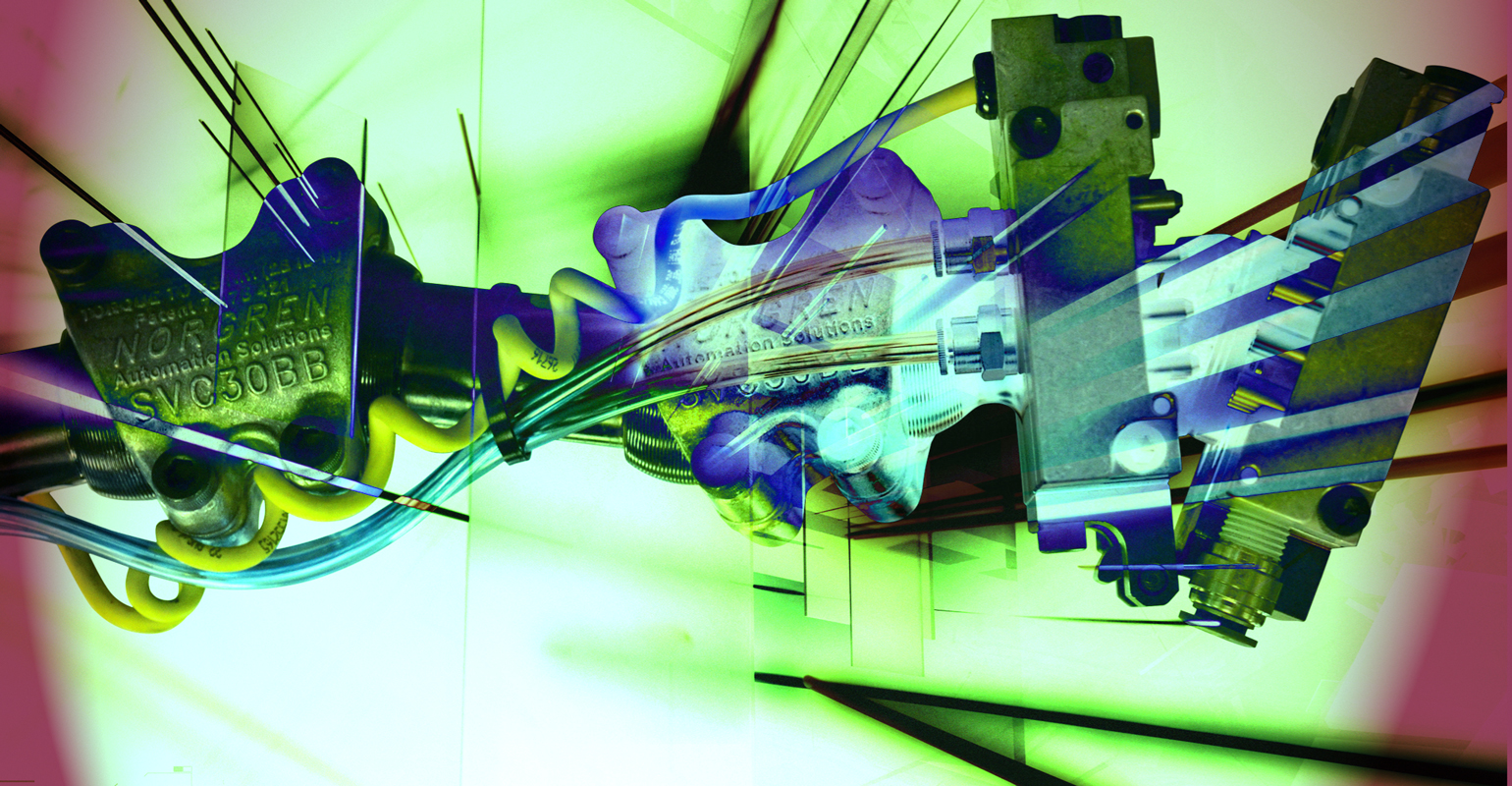

The advent of quick tool changer technology is poised to address these challenges and radically alter the tool changeover process. In this system, the receiver portion of the tool changer is permanently attached to the face of the rail, but the tools themselves are attached to adapters that easily snap in to the receiver.
How to Perform a Changeover
When using new quick tool changer technology, the only part permanently attached to a dedicated rail is the receiver (a). Tools and end effectors are attached to adapters that snap into the receivers (b) so that tools can be easily changed as needed without removing and storing the entire rail. (Photos courtesy of Norgren Automation Solutions, LLC)
When a changeover is required, a worker grasps the tool (still attached to the rail) in one hand, pushes down the handle to release the adapter with the other hand, and then unhooks the adapter with the tool or end effector from the receiver. Storing just the tools instead of the whole rail appreciably reduces the floor space.
Tooling can easily be removed from the mounted receiver by pushing the handle to release the adapter and lifting up to unhook it. All connections are disconnected automatically.
To install the tooling needed for the next process or part, the operator guides the adapter toward the receiver, aligns it with the safety hook, and pushes it until it snaps in place.
This manual tool changer from IMI Norgren is currently available for crossbar, tandem, and tri-axis press operations. However, it clearly has a future in other robotic configurations, such as automotive assembly and other industrial processes where flexibility is desirable. To install different tooling, align the adapter with the safety hook on the receiver and snap it into place.
This simple changeover process can be accomplished in just a few minutes by one person working alone without special equipment. Through tool changers, tooling or end effectors can be changed quickly and frequently to maximize the utilization of robots for various applications.
