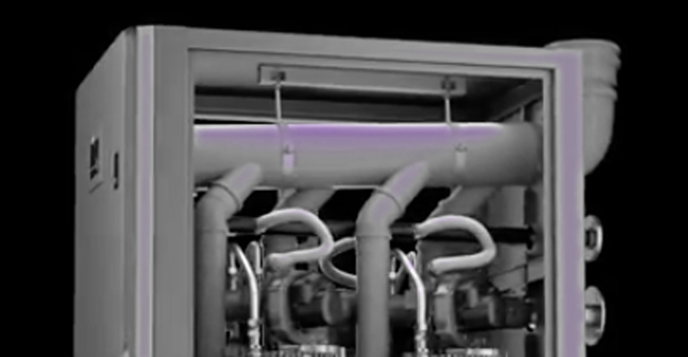

Interior of a heat exchanger in Intellihot's tankless system.
