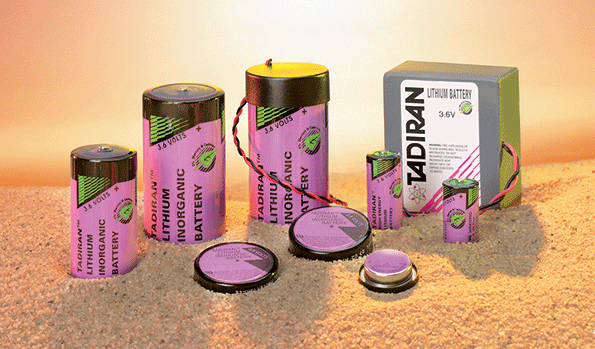

To go wireless, the preferred solution is to use a battery that can last for the entire life of the device, thereby reducing long-term maintenance expenses and reducing the total cost of ownership. Gas and water utility companies almost exclusively use long-life bobbin-type lithium thionyl chloride (LiSOCl2) batteries to power their AMR/AMI meter reading devices. For a manager, the thought of having to change out thousands of batteries every few years can be potentially chaotic, as it could overwhelm field-service crews. Large-scale battery failures can also compromise normal billing procedures and customer service functions such as disabling remote shut-off capabilities.
Bobbin-type LiSOCl2 batteries are primarily chosen for wireless devices deployed in highly remote locations due to their ability to operate up to 40 years. Some common examples include seismographic measuring devices placed at the bottom of the ocean floor, sensors that monitor structural stress to bridge trusses, and GPS tracking devices that monitor the size and location of icebergs floating in Arctic waters. Challenging applications such as these demand long-life batteries. However, if the device is easily accessible and operates within a moderate temperature range, then a less expensive consumer-grade primary or rechargeable battery could suffice. Every application is unique, so design engineers need to consider the full range of performance requirements and the operating environment to determine the ideal power source.
Primary lithium batteries predominantly power remote wireless devices that require long operating life.

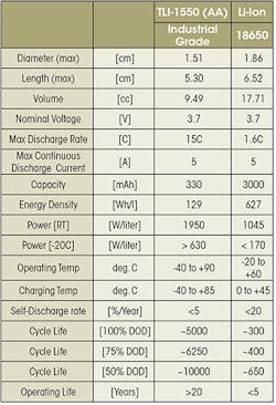

If consumer-grade Li-ion batteries are being considered, the design engineer needs to be mindful of their limitations, including a maximum operation life of five years and 500 recharge cycles, as well as an inability to deliver the high pulses required for two-way wireless communications.
For industrial-grade energy harvesting applications that demand a more reliable long-life power source, a new generation of industrial-grade rechargeable Li-ion batteries has been developed that can deliver 20-year operating life and 5,000 full recharge cycles, along with the ability to deliver up to 15A pulses to power two-way wireless communications.
The table provides a comparison between typical lithium-ion batteries and industrial grade lithium-ion batteries.
