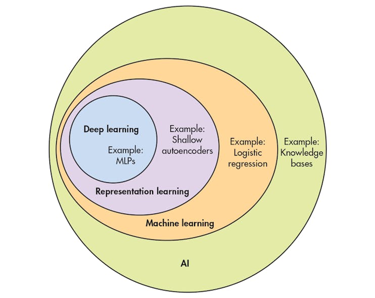

This Venn diagram, which appears in the book Deep Learning (MIT Press), helps illustrate how deep learning, machine learning, and representation learning are all a part of artificial intelligence.
