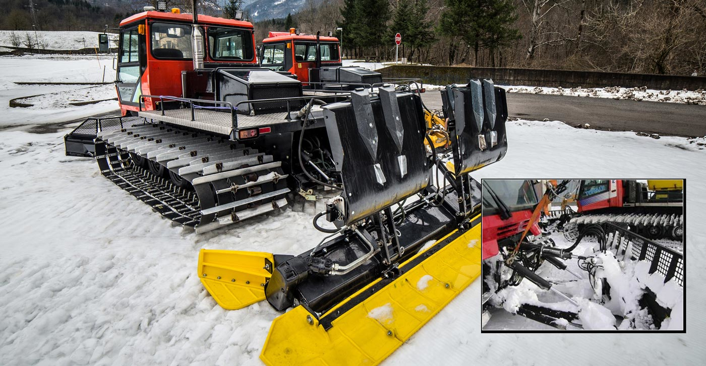

Snow Cat

Hoses and couplings play critical roles in how hydraulic systems perform.
