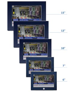

Some automation panels, including GE’s QuickPanel come in a variety of sizes. This lets companies tailor the panel to the application and work environment.
