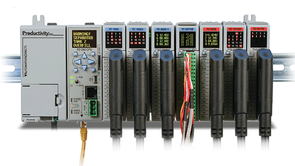

To start out small with future IoT expansion in mind, the specified control system must have the required protocol support and communication capabilities, along with built-in data logging and web-server functionality. For example, this Productivity 2000 controller offers “controls and required IoT-related network connection and data capabilities for future expansion,” said Jeff Payne, Automation Controls Group Product Manager at AutomationDirect.
