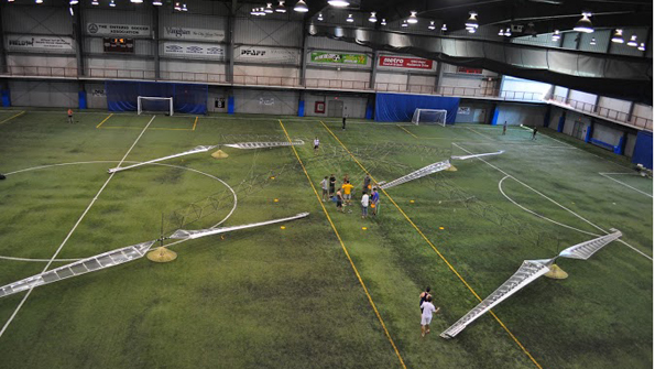

The quad-rotor design of the Atlas met the standard requirements set by the American Helicopter Society, reaching 3-m altitude and flying within a 10-m border.
The Cervélo bike frame is suspended by Vectran wire bracing, which connects to a carbon fiber truss structure. The pilot generates 550 W. of energy to power Atlas, up to 60 seconds.

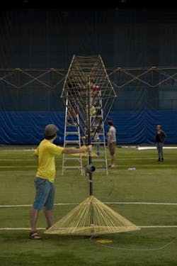

Here is one out of four rotor spools, connected under the rotor, to a drive spool on the bike frame. When the pilot pedals, he pulls the Vectran drive lines.
