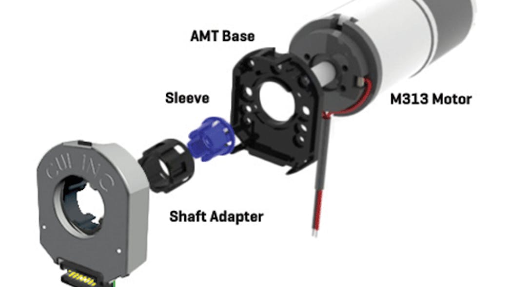

This exploded view of a capacitive encoder, the AMT11 from CUI Inc., shows the hardware that is attached to the motor shaft.
There is another benefit, although a less obvious one, for those who fine-tune proportional-integral-derivative (PID) control loops: the ability to adjust the encoder’s ppr count to get the best performance without changing encoders. This ability to dynamically modify the resolution simplifies system optimization, which is usually done by adjusting the code or changing the encoder’s line count (resolution). With optical encoders, this latter process requires different encoders be purchased and installed, increasing overall cost and lengthening design cycles. With capacitive-based encoders, control engineers simply change the encoder’s line count parameter of the encoder until they get the control-loop result they want.
Capacitive encoders also bring benefits in installation and production. Mechanically, their mounting holes are matched to those of other types of encoder, making them a fit-and-function compatible unit and a drop-in replacement. Thus, a single encoder can be fitted to different diameter shafts simply by using adapter sleeves, which reduces the number of stock-keeping units in production and repair inventory.

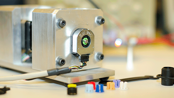

Here is a capacitive encoder, the AMT 11 from Cui Inc. It has a 1.45-in.c diameter and is 0.4 in. thick. It operates from a 5-V supply and provides both single-ended CMOS incremental-position quadrature (90 deg) and differential line driver outputs that are electrically compatible with conventional optical- and magnetic-encoder signals. It has a wide range of programmable resolution choices ranging from 48 to 4096 ppr, plus a once-per-revolution indexing pulse. Axial and radial connection orientations are available depending, on application requirements. And it operates in temperate ranging from -40° to 105°C.
