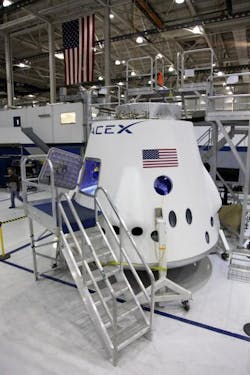

A Dragon V2 sits in the SpaceX construction hangar as it undergoes tests.
The Dragon V2 will carry up to seven crewmembers or a mix of crew and cargo. None of the crew members needs to be a pilot because SpaceX is designed to be totally autonomous. It can fly unpiloted into orbit atop one of SpaceX’s Falcon 9 launch vehicles, rendezvous and dock with the space station, then re-enter the atmosphere and land on Earth. If needed, an astronaut can manually override the automatic pilot.
The capsule is equipped with eight SuperDraco thrusters, each with 16,400 lb of thrust, that will let it touch down on dry land when returning to Earth. This “soft-landing” capability could come in handy if the capsule is chosen for a return mission to the moon or one to Mars. The capsule also carries parachutes in case an emergency landing is necessary. Because the Dragon V2 lands on solid ground, it can be quickly refueled and prepared for another mission. SpaceX says the capsule will be able to complete 10 flights before a major overhaul is needed.
The thrusters, which can be throttled and turned on or off at any time, are also key components of an escape subsystem that will safely carry the capsule and passengers to safety in case of an accident. The escape plan will work anytime during launch –from when the crew first straps in on the launch pad to when the Dragon V2 capsule enters orbit. The thrusters were 3D printed out of Inconel using direct metal laser sintering.
SuperDraco thrusters on the Dragon V2 fire, bringing it to a safe landing in this flight test.
SpaceX will be upgrading the current cargo-only version of the Dragon to make it capable of carrying astronauts. For example, they will add impact-attenuating landing legs, larger windows, and an ISS docking adapter, as well as upgrade the phenolic-impregnated carbon ablator (a heat shield). It could make its first flight next year, and carry its first human crews in test flights in 2016.

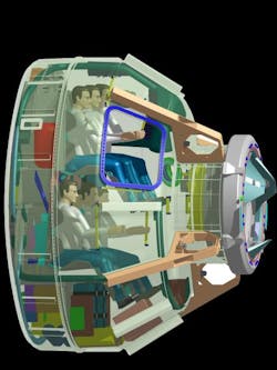

The Boeing CST-100 also carries seven crewmembers or a mix of cargo and crew and can be reused 10 times before needing to be refurbished. The hull of the 10-ton capsule contains no welds, which should make it easier to assemble and less prone to defects.
It’s a tight fit, but seven crew members fit inside the CST-100 capsule. (Courtesy of Boeing)
