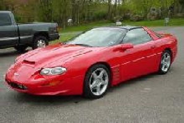

Sidebar : A SUPERNATURAL CAMARO
One of the latest projects from Callaway Cars is the SuperNatural Camaro C8, a series of aftermarket packages built for the Chevrolet Camaro. These can be bought and installed individually or in combination, with some boosting power and performance and others purely cosmetic. With all of the Callaway components installed, the C8 Camaro accelerates from 0 to 60 mph in 4.8 sec, has a top speed of 173 mph, and still meets emission requirements in all 50 states.
At the heart of the SuperNatural Camaro is a 383 in3 bored and stroked OHV V8 engine. It features a nitrided crankshaft, Carillo connecting rods, 10.5:1 forged pistons, and cylinder heads ported and matched on a 4-axis LeBlond Makino machining center. The powerplant puts out 404 hp, nearly 50% more than the standard Z28 engine, and 412 lb-ft of torque at 4,500 rpm, an increase of 25% over the stock car.
Two other engine systems, an air intake and an exhaust, can be installed on stock Camaro motors or the SuperNatural 383. The Honker air system uses a molded composite duct and high-flow air filter to increase air flow by 50% over the original air filter. Unlike the original, it takes relatively cool, clean air from outside the engine compartment. Putting the Honker on a stock Camaro adds 16 hp; putting it on the SuperNatural Camaro adds 35 hp, according to Mike Zoner, chief engineer for Callaway.
The Callaway exhaust system consists of tubular stainless steel headers, an intermediate pipe, and a proprietary design, low restriction muffler. Borrowing techniques usually reserved for race cars, Callaway uses stainless steel CNC-machined flanges hand-heliarced to full 1.75-in. primaries made from mandrel bent tubing. This and the Honker yield the biggest horsepower gains without internal engine work, and both are required to get the most out of the SuperNatural 383.
To improve handling and stopping power, a beefed-up suspension adds new trailing arms, strut tower brace, and a tubular lateral link stabilizer to the rear, with stiffer front and rear stabilizer bars to control body lean. A set of high-rate coil springs lowers the center of gravity for better handling, but at the cost of less ground clearance. Koni double adjustable shock absorbers contribute to better handling. Callaway also replaces the 2-piston front brakes with racing-grade 4-piston brakes having an increased swept area and better cooling. The Callaway/Brembo brakes will stop a C8 going 60 mph in 120 ft, and one going 80 mph in 212 ft.
Callaway also provides the CamAerobody, an aerodynamic body package designed by Paul Deutschman, that restyles the exterior and enhances the vehicle’s aerodynamic performance. The new front end, for example, transforms the Camaro from a “bottom breather” into a “front breather.” This reduces lift on the vehicle at high speeds and improves air flow for engine cooling. Down forces on the car and aerodynamic efficiency are further enhanced by the flush, glass-covered headlights and small winglets on either side of the air inlet. Deeper reprofiled side skirts reduce the amount of unwanted air under the vehicle and improve stability, while extractor grills behind the front and rear wheel arches move air quickly through the engine compartment.
Other add-ons include a leather interior and wood veneer accents, a custom shifter, and wider 17-in. wheels with B.F. Goodrich Comp T/A ZR tires.
