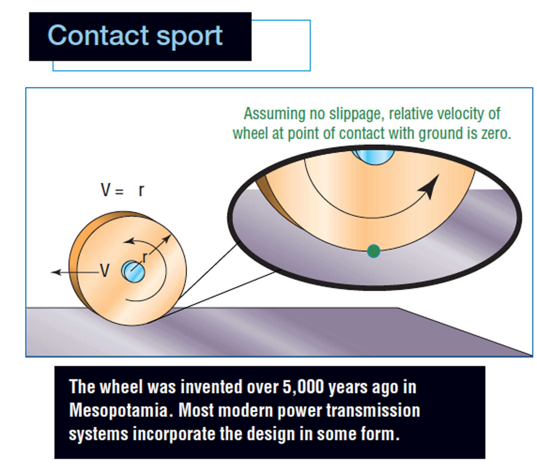

The less work required to translate an object, the better. Avoiding sliding friction — a major sinkhole of applied force for motion.
The less work required to translate an object, the better. Avoiding sliding friction — a major sinkhole of applied force for motion — is accomplished through rolling.
The perfect mechanism for this motion is a rolling wheel that turns on its axle to move along its trajectory. Assuming no slippage, its relative motion with the contact surface is zero. Thus the wheel’s rotational motion is translated into its system’s linear speed by the simple equation V = v x r, where v is rotational speed.
The linear distance a rolling wheel traverses depends on two factors: its rotational displacement and its radius, as governed by the equation D = u x r, where u is rotational displacement in radians.

Q: How is a wheel made more efficient?
A: Ironically, with increased friction at the rolling contact surface. Wheels need maximum friction (or minimum slippage) with contact surfaces to work effectively. Designs that get closest to no-slip conditions are gear and chainsprocket designs. Positive mechanical engagement of the teeth raises the efficiency of power transmission. Frictiondrive mechanisms, such as toothless belts on wheel pulleys and wheels with rubberized outer races (such as tires on automobiles) mitigate slipping through increased friction between contact surfaces.
