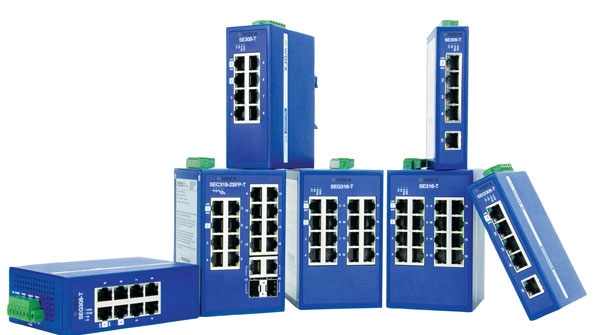

Companies offer user-friendly plug-and-play switches unmanaged, light managed, and managed. Engineers should be knowledgeable of the cost and benefits of each to see what will work best for their application. The eWorx line from Advantech is a series of monitored (unmanaged to light-managed) switches. This product is a part of the SE30x family of switches that support Modbus/TCP to communicate with SCADA software, and SNMP to communicate with NMS (Networking Management System) at the same time. This gives full read control to both control engineers and IT.
