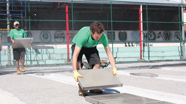

Piezoeletric tiles convert pressure and vibration from people walking on them into electricity to light walkways and fields. (Credit: Pavegen Systems)
