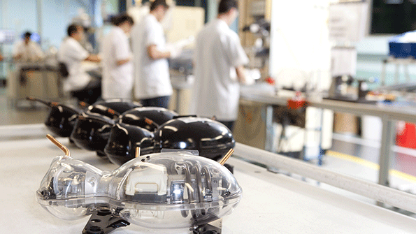

Now, with Embraco’s Wisemotion compressors, the new refrigerator’s energy consumption will fall below 1 kWh per day. Created in the early 2000s, Wisemotion compressors don’t require translation from rotational to linear motion to move the piston. Rather, motor-powered linear spring displacement directly drives the piston.
Removal of the rotating parts lowers noise and eliminates the need for oil lubrication—moving parts instead use the refrigerant gas for lubrication. To save power as well as keep food fresher for longer, Wisemotion maintains a minimum piston stroke displacement, keeping the fridge above a minimum temperature setting and lengthening stroke for a higher refrigerant pump rate.
