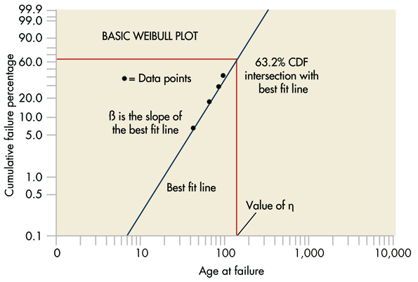

This Weibull plot shows a best-fit line with a slope of beta going through four data points. The value for eta is derived by taking the point on the best-fit line that intersects with a line drawn from the y or CDF axis at 63.2%, then finding the corresponding value on the x or “Age at failure” axis.
Eta (η) represents the characteristic life of an item, defined as the time at which 63.2% of the population has failed. The shape parameter, beta (β), is the slope of the best-fit line through the data points on a Weibull plot. The variable t represents the time of interest when solving these equations. (See the graph Basic Weibull Plot.) The hazard rate describes how surviving members of a population are failing at a given time. The hazard rate and Weibull shape parameter, beta, have a distinct relationship. ▶ When β < 1, the hazard rate decreases with time (reflecting infant mortality or failures soon after rolling off the production line). ▶ When β=1, the hazard rate is constant over time. ▶ When β > 1, the hazard rate increases with time (population wearout or products wearing out at an increasing rate as time passes). Weibull distributions can also take the form of other statistical distributions depending on their β values. ▶ When β < 1, the Weibull PDF is the same as the gamma distribution. ▶ When β = 1, the PDF reduces to the exponential distribution with a failure rate, λ, equal to 1⁄η. ▶ When β = 2, the Weibull PDF becomes the Rayleigh distribution (failure rate linearly increasing with time). ▶ Data that fall into a normal distribution also generate good Weibull plots, with β ≥ 3.4.
