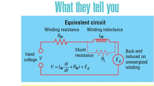

Motor models can be a great help when it comes to designing the control portion of a motion system
Motor models can be a great help when it comes to designing the control portion of a motion system. The relatively simple construction of motors — copper coils, iron cores, and magnets — readily reduces to an equivalent electrical circuit. In this way, ac, dc, brushed, brushless, and reluctance motors can be represented as a combination of resistors, inductors, and voltage sources. These models can be solved to generate speed-torque curves and to quantify the effect of voltage and current on motor operation. The following analysis applies to brushless dc and permanent magnet type motors.
