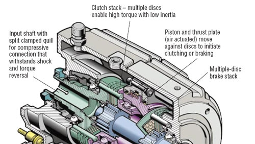

Shaft connections are crucial in a shock-load situation. Quill connections used in clutch-brakes and gearboxes take a beating in high-cycle applications. Standard quill connections have a loose shaft fit, for assembly purposes, and with each indexing move the key is hit with hammer-like force, so it distorts or wears out quickly. Furthermore, it can cause galling, making disassembly a problem. Similarly, slip-fit keyed connections used on coupling and pulley attachments are prone to pounding with each torque reversal, and will fail quickly with the high number of cycles involved. It’s expedient, then, to use tight-fit bores and compression-type connections.

For numerous reasons, air actuated oil shear clutch-brakes work very well in extreme high-cycle machinery. They generate the least amount of heat from friction and actuation, and the multiple disc arrangement provides high torque with low inertia by adding discs rather than increasing disc diameter. Additional cooling measures such as a fan or coolant circulating through a heat exchanger increase thermal capacity considerably.

When using pneumatic clutch-brakes keep the connecting hoses short or use manifold-mounted valves. Accumulators will improve consistency and enable increased cycle rates. They should be 10 to 20 times the piston volume, with regulators located at the accumulators’ input sides. Properly sized air valves are critically important. Allowing the fullest airflow possible is always desirable, but larger valves may respond slower. A balance is needed between the valve size, valve speed, and CV rating, a parameter relating airflow to valve size. In some cases two smaller valves (as opposed to one large valve) may be the best solution.
