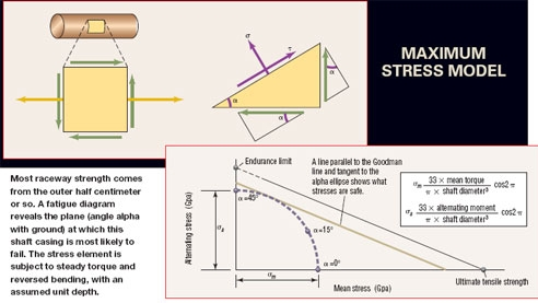

Because shafts provide the inner raceways for all linear bearings, theirs is often lumped into bearing design as an afterthought
Because shafts provide the inner raceways for all linear bearings, theirs is often lumped into bearing design as an afterthought. But bearing raceway sections on shafts are very critical because some (if not most) bearing failures actually result from shaft problems; variances translate through bearings to surrounding equipment. Carefully considering shaft dimensions, surface finishes, and hardness improves uniform load distribution, improved system accuracy, and life.

Tolerances don’t mean much if they don’t last. Two things — magnitude and depth — determine the extent to which hardening extends life. To maximize benefits, evenness is paramount. Sudden hardness drop-offs at shallow depths can cause surfaces to become brittle and wear prematurely. Dropoffs deeper in the material minimize the positive effects of hardening. At the very least, raceway areas should be surface hardened with reasonable core strength for full bearing capacity. Steels high in sulfur or lead are not acceptable. Oil holes are okay in raceway areas, but edges should be gently blended.
