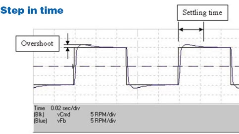

One way to gauge loop performance is to look at the time-based response to a step command. Overshoot (the ratio of the peak to the final value) is a measure of stability, while settling time (the time it takes the signal to settle within, say, 3% of its final value) tells you how responsive the system will be.

Gain curves tend to be the easiest to interpret if you're trying to get a handle on stability and response. For the latter, your best bet is to look at bandwidth, the frequency where the gain falls to -3 dB. In general, the higher the bandwidth, the more responsive the system.
If you're concerned with stability, you can get a pretty good idea from the amount of "peaking" in the curve. A peak of more than 1 or 2 dB, before the gain plot starts to fall, is usually considered excessive.
