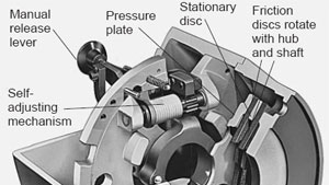

Operation. Motor brakes generally use friction between mating surfaces to stop or hold a load. The same brake can be used for both of these functions, but if stopping time is important, the brake must have sufficient torque to stop within the allotted time.
Actuation is either through electrical, mechanical, or pneumatic methods. Most motor brakes are mechanically actuated and electrically released. Called power-off brakes, they provide fail-safe operation by engaging when electrical power is removed for any reason, thereby holding the driven machine or load. When power is restored, the brakes release.
They generate friction and braking torque in one of two ways — spring set or permanent magnet. Both methods use an electrical coil that, when voltage is applied, moves the friction faces apart to disengage the brake. Pneumatic actuation is described later.
With spring-set brakes, you have little control over the deceleration rate — they simply stop at a rate dictated by their mechanical characteristics (mainly spring force and coefficient of friction). Some spring-set brakes have an adjustable nut for changing the spring force, and thus the deceleration rate. Other types require using a unit with a different spring or a different friction material. Either approach lets you reduce the deceleration rate. But it also increases the stopping time and reduces the braking force.
