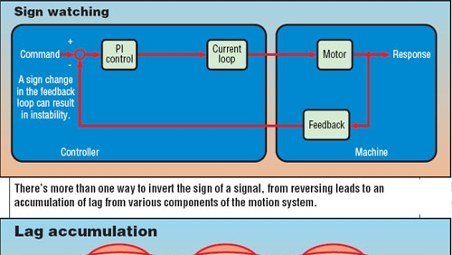

It may sound counter-intuitive, but control loops must have negative feedback. Consider a PI controller connected
It may sound counter-intuitive, but control loops must have negative feedback. Consider a PI controller connected through a current loop to a motor. Motor velocity is measured from a feedback device and connected through the summing junction to close the loop. If the sign of the feedback signal at the summing junction is reversed, the system will become unstable. But what factors or conditions can reverse a feedback signal’s sign, and how do you know when it happens? One way to invert the sign is to incorrectly wire the leads of a tachometer. Do that and the system will run away.
The problem with positive feedback is that it causes the error or correction signal from the loop to move in the wrong direction. If you command positive response, the response indeed is positive. However, the inverted feedback signal indicates the response is negative. Misreading this signal, the controller produces more positive command, which in turn produces more positive response, and the cycle continues with the motor running away at full speed.
Incorrect wiring isn’t the only way to produce a sign change in the loop, though. In the March column, we discussed how every block in a control loop has phase lag. Accumulating a sufficient amount of phase lag around the loop can also result in positive feedback. Unlike reversing feedback leads, however, this instability usually occurs at just one frequency. This is why unstable control systems oscillate rather than run away like they do when you reverse the feedback leads.
We usually don’t think of an instability at a particular frequency, especially a high frequency, as presenting a serious problem. Rather, we avoid exciting the control system at the oscillatory frequency. Unfortunately, all systems have noise and noise contains virtually all frequencies. If a system is unstable at any frequency, nature will find it, and usually within a few milliseconds.
Let’s look at a system model running with a sine wave command of 414 Hz, and account for all the phase lag around the loop. Typically, PI controllers generate very little phase lag at high frequencies. In this case, it’s 2°. The current loop, which always has some lag, generates 47°. For our purposes, the current loop can be regarded as a low-pass filter. The higher the frequency, however, the greater the phase lag.
The motor itself introduces a 90° lag. For our simple model, we can assume that the phase lag from the motor will always be 90°. That’s because we are thinking of the motor as an integrator, which has a fixed 90° lag, and ignoring friction which tends to reduce phase lag a little. The effects of friction are usually small enough to safely ignore.
For feedback, we can assume that we’re using a resolver and processing the signal with a resolver-to-digital converter. RDCs are selfcontained control systems themselves and generate phase lag similar to low-pass filters. The phase lag for the resolver feedback at 414 Hz is 41°. So at 414 Hz, the sum of the phase lag from the PI controller, the current loop, the motor, and feedback is 180°. This means that at 414 Hz, as the signal traverses the loop, its sign is “reversed,” generating positive feedback.
For most control systems, there is a frequency where the phase lag accumulates to 180°, but this alone does not cause instability. Suppose the loop gain was very low, say 10%. The sign reversal would not cause sustained oscillations because the signal is thoroughly attenuated as it travels through the loop. For instability, the sign must be reversed and the gain through the loop must be unity.
