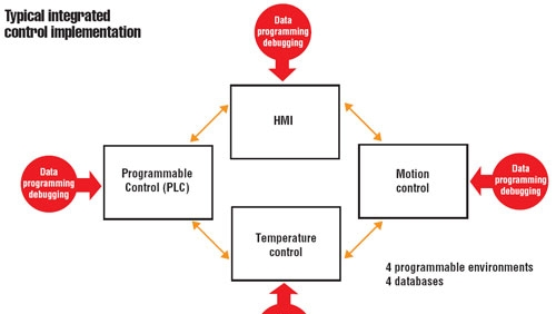

Most motion control solutions consist of a PLC, HMI device, and a motion controller with its DSPs and dedicated microprocessors. If the application involves complex motion profiles tightly synchronized with the associated logic, such a system can be a nightmare to program. The designer may face as many as five separate programming environments andtheir databases.
In addition, designers must integrate the associated communication drivers. This is often a difficult task because the drivers may be limited in the parameters they can access. And it can take hours of programming just to establish communications.
After these tasks are accomplished, however, designers must still synchronize the newly integrated system with the process. Add a vision system on top of this, and you can plan on getting tangled in a nasty web of programming.
Debugging can be even more difficult as the system may not offer the proper tools for real-time viewing of parameters as they pass between the three components.
