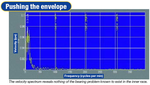

Velocity measurements indicate the speed of vibrations that result from bearing flaws and roughness. Velocity, rather than acceleration, is best when low-frequency vibrations are expected, typically below 60 Hz. A common way of obtaining velocity is by integrating the output of an accelerometer. The measurement is further enhanced by data collectors with enough dynamic range to pick up faint signals, such as those generated by rolling elements passing over flaws in the races, or by defects in a ball or cage.
One problem, however, is that when higher frequencies are a concern, velocity levels don't usually climb very high, even with very large, deliberately induced flaws. When bearing elements vibrate and displace because of defects, they don't generally get a lot of speed going, even though the changes in speed can be abrupt.
In one case, a substantial flaw only triggered a velocity response of 0.0027 ips (at around 107 Hz) at a shaft speed of 1,800 rpm – although far from invisible, it wasn't enough to get caretakers anxious about performing maintenance. Now consider the same bearing with a shaft speed of 180 rpm, as on a paper machine. The amplitude will read a mere 0.00027 ips for a bearing that should be replaced. Clearly something else is needed to evaluate the condition of rolling element bearings.

In the last few years, the mathematical signal processing method known as enveloping has been incorporated into portable data collectors. This computational technique, initially developed in Europe back in the 1970's, used to be limited to lab analysis.
Enveloping uses high-pass filters to collect the signals generated by rolling bearings with flawed rings, cages or rollers. Mathematical manipulation enhances the repetitive signal components, while suppressing random signals. The process then sums the energy, passes it through a Fast Fourier Transform (FFT), demodulates it, and presents it in the selected frequency range as an enveloped acceleration (gE) spectrum.
By using the enveloped signals coupled with demodulation, the resultant FFT can have a starting point of zero without any electronic "ski slope" as seen in velocity measurements, and without the roll-off at the low end of an accelerometer's range.
Using an enveloped Fourier transform brings out very low signals, but the transform itself also provides positive evidence of bearing damage. A rotating bearing free of defects translates into a sine wave. With damage present, the sine wave is clipped or truncated, giving it a Fourier transform consisting of the fundamental frequency plus harmonics. Harmonics in the FFT of a bearing indicate trouble.
Using the enveloping method, it's possible to evaluate bearings rotating very slowly, down to 0.5 rpm. A side benefit is that it can also detect looseness. If the rotating components of a machine are loose, or if the machine itself is loose on its base, the sine wave is again clipped, and shaft speed harmonics crop up in the FFT display.
