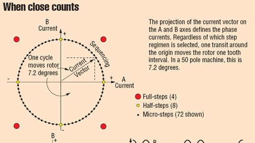

In a step motor, perfectly spaced states divide the electrical cycle into an integral number of equal intervals. If the rotor followed the excitation signal with perfectly spaced incremental moves, microstepping would be, without question, more accurate than full-step. But step motors are not perfect. No matter how finely you articulate the electrical cycle, there will be some amount of error.

Step-motor drives must accurately produce the required microstepping currents. The ideal current waves are in temporal quadrature (the A and B pulses) during movement and display half-wave symmetry. Any deviation is erroneous and will have some harmful effect depending on the character and severity of the distortion. Defects can produce significant, often severe, vibration at low speed, and cyclic-position error at rest.
Drive induced errors fall into six major categories: offset, crossover distortion, diagonal clipping, phase balance, current loop instability, and quantization noise.
Offset. Offset is simply the unintended introduction of a dc component to either or both phase currents. In the electrical state diagram the phase-current pattern appears displaced from center.
Offset produces cyclic error and torque ripple in synchronism with the electrical pole rate – 50 cycles/revolution. An offset of 1% causes a cyclic error of approximately 1 microstep at 25,000 steps/rev. Some drive manufacturers provide fine adjustments to precisely null output offsets.
