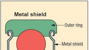

Integral seals are compact, and eliminate the need for grease cavities and shaft seals, which can require more space and impose a mechanical burden on the shaft. Bearings sealed this way are truly self-contained, and therefore safe from the possibility of contamination from handling or from a shared lubricant.
The three basic kinds of integral seals are metal shield (non-contacting), noncontact rubber, and contact rubber. The metal shield is perhaps the most common and inexpensive configuration. The metal is pressed into the outer ring of the bearing, while the groove on the inner ring and the lip on the inside diameter of the shield assemble with some clearance, but with a labyrinth cross section that blocks the entrance of particles. And the inner ring groove is such that any exiting grease tends to be thrown back into the bearing by centrifugal force. Since there is no contact, these shields don’t add to the bearing torque, and are great for high-speed operations, but are best used in clean environments only.
