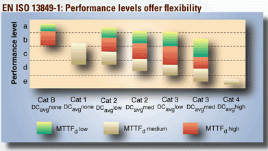

For example, in conducting a risk assessment under EN ISO 13849-1, a designer may find that Performance Level (PL) d is required. A Category 2 (zero-fault-tolerant) structure with very high mean time to dangerous failure and low diagnostic coverage may be the least costly solution. At the other end of the spectrum, a Category 3 (single fault tolerant) system with medium diagnostics may be ideal. Rather than being conservative and potentially overcompensating, this approach gives designers more flexibility to specify an optimum level of safety for individual application demands.
