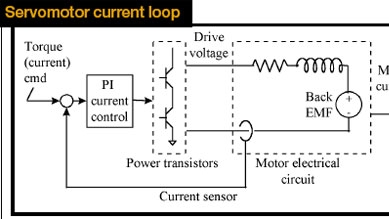

Electric motor drives (also known as inverters or amplifiers) use power transistors to handle electrical energy. The transistors actually control voltage; current is the result of the voltage dropped across the motor windings. Inasmuch as power transistors are voltage devices, a current loop is required to achieve current control.
A typical current loop compares torque (current) commands to the feedback from a current sensor and adjusts the drive voltage accordingly to minimize error. Not all drives use current loops, however. Many just output a voltage, relying on motor parameters to limit the current. This may work in some applications, but it's not intended for high power (> 500 W) or demanding machines.

Although the torque of a brushless motor isn't proportional to current in any one winding as with brush motors, similar relationships are present in that the servo loop commands torque and the drive applies voltage. So here again, a current loop is still the best way to regulate voltage in order to produce the currents that make the torque.

Usually a current loop can be simplified to look like a filter with a Bode plot similar to the loop itself. A current loop on a drive with a bandwidth of 800 Hz, for example, can be modeled as a twopole, low-pass filter with an 800-Hz bandwidth. In fact, the current loop model used in the simulations for this column is just such a filter, with a bandwidth of 800 Hz and a damping ratio z of 0.7. These values will give you a good idea of what to expect from a high-performance servo drive.
