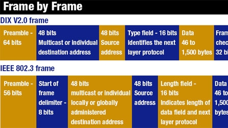

Managing changes to the original Ethernet was the responsibility of the Xerox Palo Alto Research Center after the network was completed by engineers at Xerox, DEC, and Intel. They last made changes to the specification in 1982, after which the company gave up the trademark. This last version is known as Ethernet II or DIX V2.0.
A few years later, IEEE approved specification 802.3, which is commonly referred to as Ethernet and shares some features with DIX V2.0. One difference is in the methodology for controlling network traffic. IEEE 802.3 uses a method known as CSMA/CD, or carrier sense multiple access with collision detection.
Another crucial difference can be found in the messaging format, or frames. Frames in both versions have the same number of byte fields with the same total number of bits. But several byte fields between the versions hold different numbers of bits, making interoperability uncertain.
There are ways to reconcile these differences, but they don't go far enough to enable communication. That's because DIX and 802.3 describe just the physical media needed to transmit signals and how the signals access that media. The other tasks needed for communication have been left - by design - to other specifications, or protocols.
Those protocols conform to requirements for the network and transport layers, the third and fourth of seven possible layers in any network. (The various versions of Ethernet usually handle the tasks of the first and second layers.) It's their responsibility to move data from point A to point B. Probably the most wellknown protocols for these layers are the Internet Protocol (IP) and Transmission Control Protocol (TCP).
Ethernet combined with TCP/IP is often simply called Ethernet. But the Ethernet sublayer could be either DIX or 802.3. Even though most Ethernet- TCP/IP stacks in operation use the DIX frame format, it's important to verify the version to eliminate a possible source of interoperability problems.

Industrial applications may have problems with the size of Ethernet messages. Long messages are usually not a concern. The maximum size limit is 1,500 bytes without certain overhead formatting. Third and fourth layer protocols may restrict message sizes, though. IP, for example, allows no more than 576 bytes in a frame.
The problem comes in sending just a few bits of data. The shortest Ethernet frame is 64 bytes. The data field must be a minimum of 46 bytes, otherwise the frame is viewed as a message fragment, often called a runt, and the result of a transmission error. Therefore it's "dropped;" it is not forwarded to its destination. To avoid this problem, short data fields must either be padded with other small sized data messages or filler bits.
