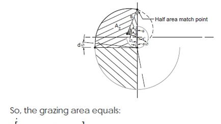

Solution to October's problem, 230 - Pet project:
You're a goat-ground-cover expert if you answered that the goat covered 1,817 ft.2 – here's how he did it:
First section the available grazing area as in the following figure:
