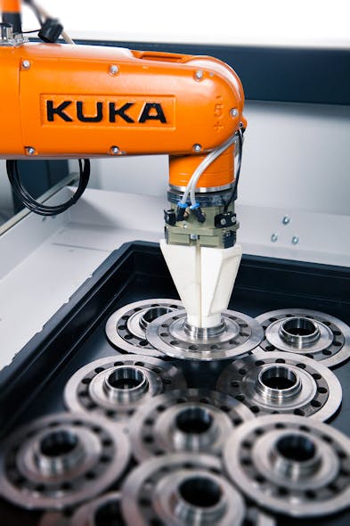

Working with Roboception GmbH, a pioneer of 3D sensor technology, KUKA Robotics developed a cost-effective system that achieves accurate robotic bin picking. Together, the two companies perfected the system that successfully blends the physical (robot) with the digital (AI)/machine learning and allows users to quickly configure and deploy the automation through a user-friendly web GUI without the need for special skill sets.
In essence, the KUKA/Roboception system allows the robot to identify which parts it can pick from a bin and which are not oriented in a reachable position or are obscured by another part. For those parts that are accessible but not in a perfect pick position, the robot makes quick adjustments.
Additionally, KUKA’s open interfaces allow for the easy integration of third-party vision solutions, such as those from SICK and Keyence Corporation of America. The SICK PLB robot guidance system is designed for precise localization of parts stored in boxes or on pallets, while Keyence’s systems address common vision system challenges and provide image stability, quality and consistency needed for bin-picking applications.
