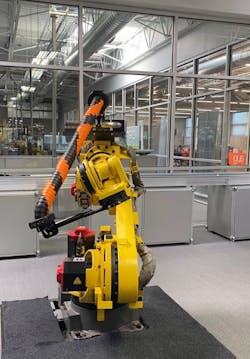

The robot cable that we manufacture is a circular cable carrier called triflex R. It is a three-dimensional cable carrier. It’s different from everything else in the market. The standard in the market right now is what’s called a corrugated hose. It’s just a solid tube, where the cables go into it. The tube has no real three-dimensionality to it, so it resists torsion and resists bending. It doesn’t like moving with the robot. Whereas, the product that we offer…it does torsion with the robot; it does bend and twist and turn with the robot; it has a lot of freedom to it. So, it relieves a lot of stress on robots.
Getting into the cable portion, robots are significantly different than standard applications. In standard applications, typically, the cables are moving in one direction—whether it be vertical or horizontal. Those are called high flex, or continuous flex cables, and their construction is significantly different from a robot or torsion-running cable.
It’s really important for designers to understand the difference, because adding a continuous flex or high flex cable into a robot dress pack, regardless of the key management you choose, can really lead to some issues. We’ve seen this particularly with cables that are communication cables, sensor cables, bus cables…anything with fine copper and braided shields.
Having the proper torsion is important, but also having a product that will relieve as much mechanical stress as humanly possible on the cable from the robot motion is important. triflex R has that built into it, with the bend radius and the torsion ability of it. And that really makes a big difference when it comes to cable life versus, say, zip ties and corrugated tube.
